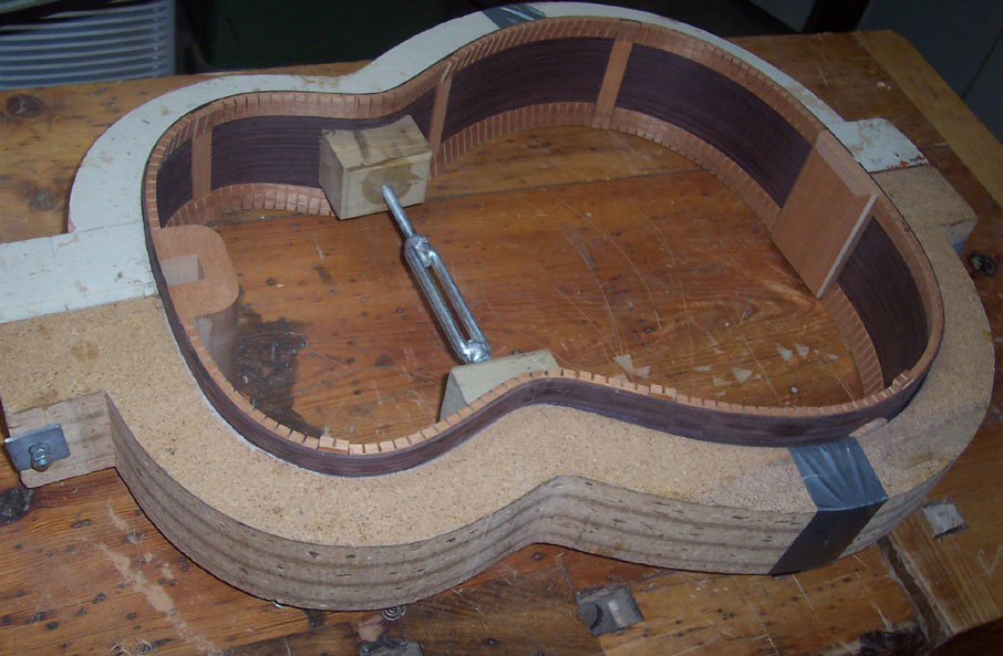

I understand the reasoning for tucking side braces inside the kerfed linings but I like to see a picture of how it should look when it is finished. I use reverse linings generally. Thanks.
PostPosted: Tue Sep 26, 2006 1:08 am
I don't have pictures, but on my last dred., I used carbon fiber mat about .005" thick saturated with thin CA. The kerfing goes right over the top with no special fitting required. On the guitars that I have built using wood for side braces, I carefully align them with the back braces, then taper them to zero under the kerfing. ( not my idea, I stole it from Santa Cruz ). Make them very thin at the exposed edge of the kerfing, and only a small notch is required for tucking.
PostPosted: Tue Sep 26, 2006 1:36 am
I do it like Benedetto shows in his book. It not the cleanest looking method perhaps, but it is simple to do, and that always is good in my book. Just glue a sections of lining over the side brace. The picture hopefully explains.
PostPosted: Tue Sep 26, 2006 2:02 am
With reverse kerfed lining, you might be better off using the bias tape a la Alan Caruth.
PostPosted: Tue Sep 26, 2006 3:08 am
My preferred method is to glue on the cloth strip. I just mask the width of the cloth with masking tape, saturate the tape with glue and put it on, wipe the excess glue off and your done. The masking take keeps everything nice and tiddy. It does the job of comtaining any cracks, looks nice and neat and covers the entire width of the side.

Todd:
With the second body in, I assume that is mahogany bracing which is just butted against linings? Maybe tape is the way to go.

[QUOTE=ToddStock] Here's a shot of bias tape and inset spruce bracing on a dread with reversed kerf linings. I use bias tape alone on everything but dreads, where the flat body sections need some extra beef to support .075-.080 sides. The OO and Size 2 in the background get just the tape.[/QUOTE]
